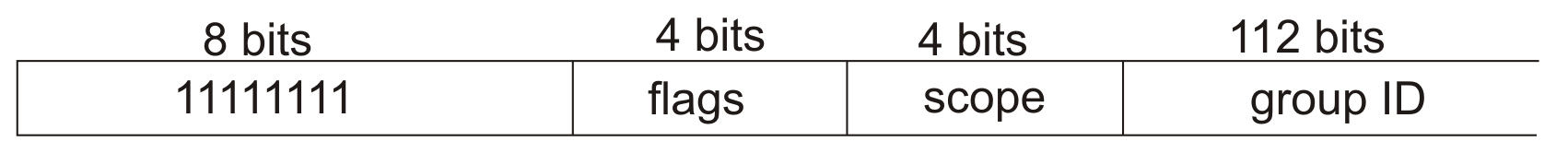

The following figure shows the format of an IPv6 multicast address.
A value of FF (11111111) in the 8 high-order bits of an IPv6 address indicates that the address is an IP multicast address.
The Multicast IPv6 Prefix is FF00::/8 (RFC3513).
The 4-bit flags field indicates whether the group is permanent or transient. The first 3 bits are reserved and the 4th bit represents the Transient flag. Currently only the Transient (T) flag is defined. A T flag set to 0 specifies a permanently assigned multicast address. A T flag set to 1 specifies a transient address.
The 112 bit group ID identifies the multicast group.
An example of a multicast address is FF01:0:0:0:0:0:0:101
The 4-bit scope field within the group ID specifies the multicast traffic scope.
